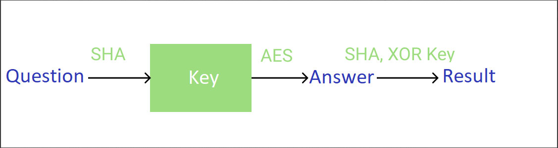

- Generate a table of Questions — random sets of characters that the application will send to the Guardant key for verification.
- Calculate a table of Answers. To do this, take a hash from each Question, then send this hash to the Guardant key and return it encrypted using the AES algorithm of a specific license feature.
- Calculate a table of Results. To do this, take a hash from each answer and perform a xor operation with the key of the software encryption algorithm (a specific one of those generated in step 2).

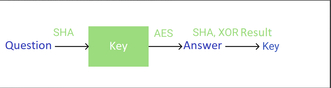

During the application operation:
The application sends a hash of a randomly selected Question to the Guardant key.
The Guardant key encrypts the question using the hardware AES algorithm and returns the Answer.
The application hashes the Answer and performs a XOR operation with the Result, which corresponds to the given Question. If the Question, Answer and Result match each other, then the output is the key for the software encryption algorithm, which can be used to decrypt the data
